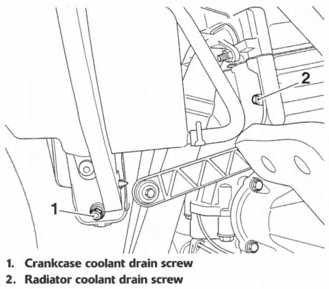

    Greetings, I have found the information here extremely valuable for performing a variety of maintenance procedures. However, I’m having difficulty finding a “how to” step-by-step procedure for draining and refilling the cooling system. I don’t have a service book...yet. Can anyone point me in the right direction?

    The process includes :
    DRAINING :
    1.  Disconnect & remove the Battery
    2.  Remove the Fairings
    3.  Remove the Fuel Tank
    4.  Remove the Radiator Coolant Pressure Cap ( Engine cold )
    5.  Position a container to catch the fluid
    6.  Remove the drain screw from the lower left side of the radiator and allow the coolant to drain
         ( Note that a small amount of coolant will remain in the system )
         ( Note that care should be taken when removing the drain screw.  A least one Member has reported
           it being very tight, and the threaded part of the radiator broke off requiring a new Radiator !
    7.  To drain the Crankcase, remove the drain screw ( on the left side of the engine ).
         Discard the sealing washer.
    FILLING : ( Pre mixed Hybrid OAT Coolant / HOAT x 2.8 Litres  )
    1.  Refit the Radiator drain plug, and tighten it to 9Nm
    2.  Using a new Sealing Washer refit the Crankcase Drain Plug and tighten it to 8Nm
    3.  Remove the Bleed screw from the top right of the Radiator ( again taking care not to break it off ! )
    4.  Slowly add the new Coolant mixture through the Radiator cap opening until full
    5.  When correctly filled Coolant should be visible through the Bleed screw opening
         and the Radiator Cap filler opening
    6.  If the Filler side appears full but Coolant is NOT visible at the Bleed Screw opening,
         attach a clear tube to the Bleed Screw spigot and syphon Coolant into it
    NOTE : The Service Manual recommends use of a hand operated syphon pump
    to syphon the Coolant through the system
    7.  If necessary top up the Coolant via the Radiator Cap Filler opening, then refit the Radiator Pressure Cap.
    8.  Refit the Radiator Bleed Screw and tighten to 9Nm
    9.  With the aid of an assistant ( or two ! ) lean the motorcycle fully over to the right hand side,
         and then the left hand side, to remove any air that might be trapped in the system
    10. Remove the Radiator Cap and top up the Coolant
    11. Refit the Radiator Cap and repeat the Leaning over and topping process as necessary
          until all trapped air has been removed

    A least one Member has reported it being very tight, and the threaded part of the radiator broke off requiring a new Radiator !
    Yes, I remember that being reported. Dunno what the rest of you feel about that but maybe it's safer to leave that drain screw alone and just pull the bottom hose off. :187:

    I had also read the issue about the radiator drain plug and bleeder plug. I just completed the job and I’m happy to report that I did not have any issues with those. It appears that the factory painted the radiator AFTER the plugs were installed. Thanks again!
