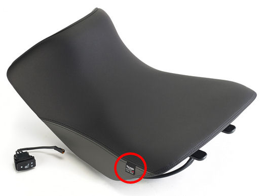

    • I didn't remember to fully test the seat warmer. I only put on last 2 mins of ride, wasn't convinced it felt warm, and it didn't show up on the dash like it should so maybe was swapped out?

    Regarding the Heated Seat - ( all Heated Seats were optional additional accessories ),
    it's easy to tell if it is the Heated Seat as there should be a Tag Label
    visible at the rear left of the seat that says "Triumph Heated" or similar,
    or if you remove the seat ( operate the keyed lock above the rear light
    to release the Pillion Seat, remove that then lift the Rider Seat off ),
    the wiring for the Heated Seat will be obvious.
    ( There should also be the Switch fitted in the left side panel ).
    No wiring means it's not a Heated Seat.
