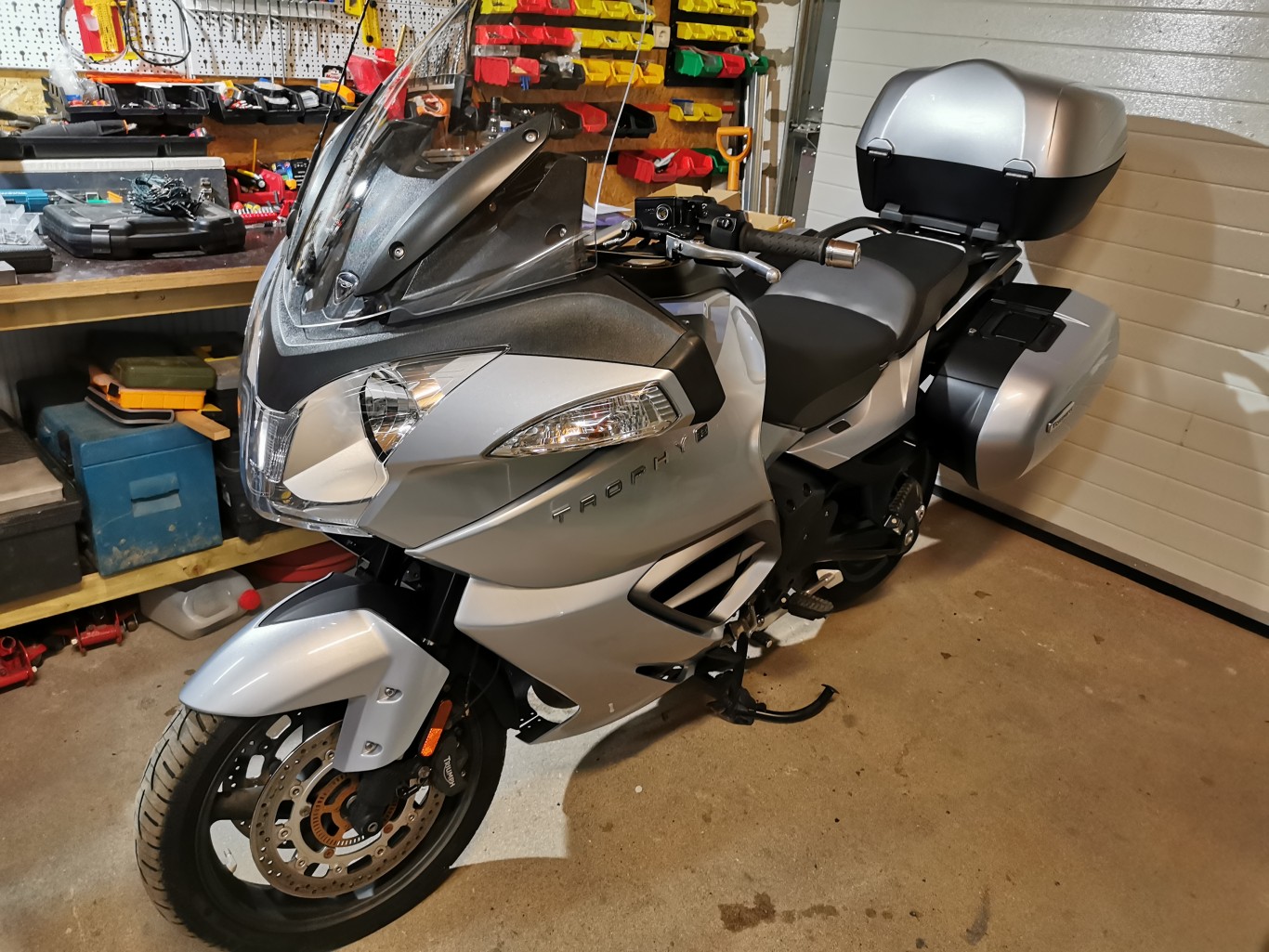

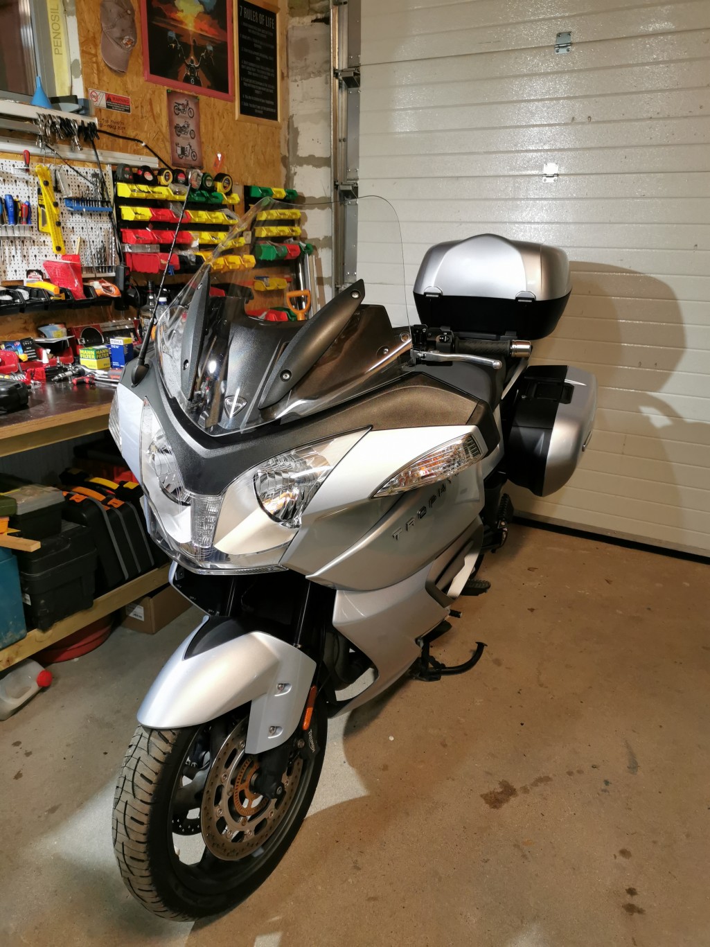

Hello, folks and many thanks for welcoming!
I got my new ride, and already she kept me busy for some time. I stripped it down - removed all fairings as few things need to be taken care of.
Changed oil and filter, but want also to change air filter and also access the oil pressure switch - oil pressure warning light tests ok but then extinguishes before engine is started. This needs to be investigated. And overall now it is good time to learn how she is built. I like the way she is put together, good solutions.
My TT SE is 2014, with 10 500 miles on it. But seems in 6 years she has not seen a lot of love. The gear lever was almost seized, a bit dirty, whoever changed the battery - left the + terminal completely lose - barely touching, therefore it was badly heating up.
But she will be alright in couple of weeks when some parts arrive, and backrest pad for my dear. One more step - to get heated seats installed.
I had to put fairings back together bot not completely as tomorrow comes the inspector from registration office to check it (VIN/documentation), so don't be surprised some bits still missing - I will strip her again... Wife says if she feels I have lost - I'm in a garage with my new TT...
