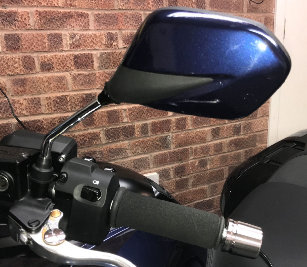

         Can't thank you enough for the awesome response, I hate to ask so many questions but I can't help myself.I see that you have a 2nd set of mirrors, I like the idea, the better the view(s) the safer. Any recommendations on mirrors and how did you mount the mirror on your left side (as shown in your pic's next to your existing fairing mirror?

The mirrors were just a cheap pair of "eBay" - I liked the look of them
which fitted in well with the lines of the bike.  I don't think they are available now  :
After the above Photo was taken I added a RAM Ball mount - which is on a Flat Plate
that fits between the Mirror and the Clutch Master Cyclinder casting.
The clutch and front brake Master cylinders both have threaded holes in them.
The holes have a rubber blank in them when the bike is new - they just pry out,
to reveal the holes which are an M10 x 1.25 standard right hand thread for both mirrors.
