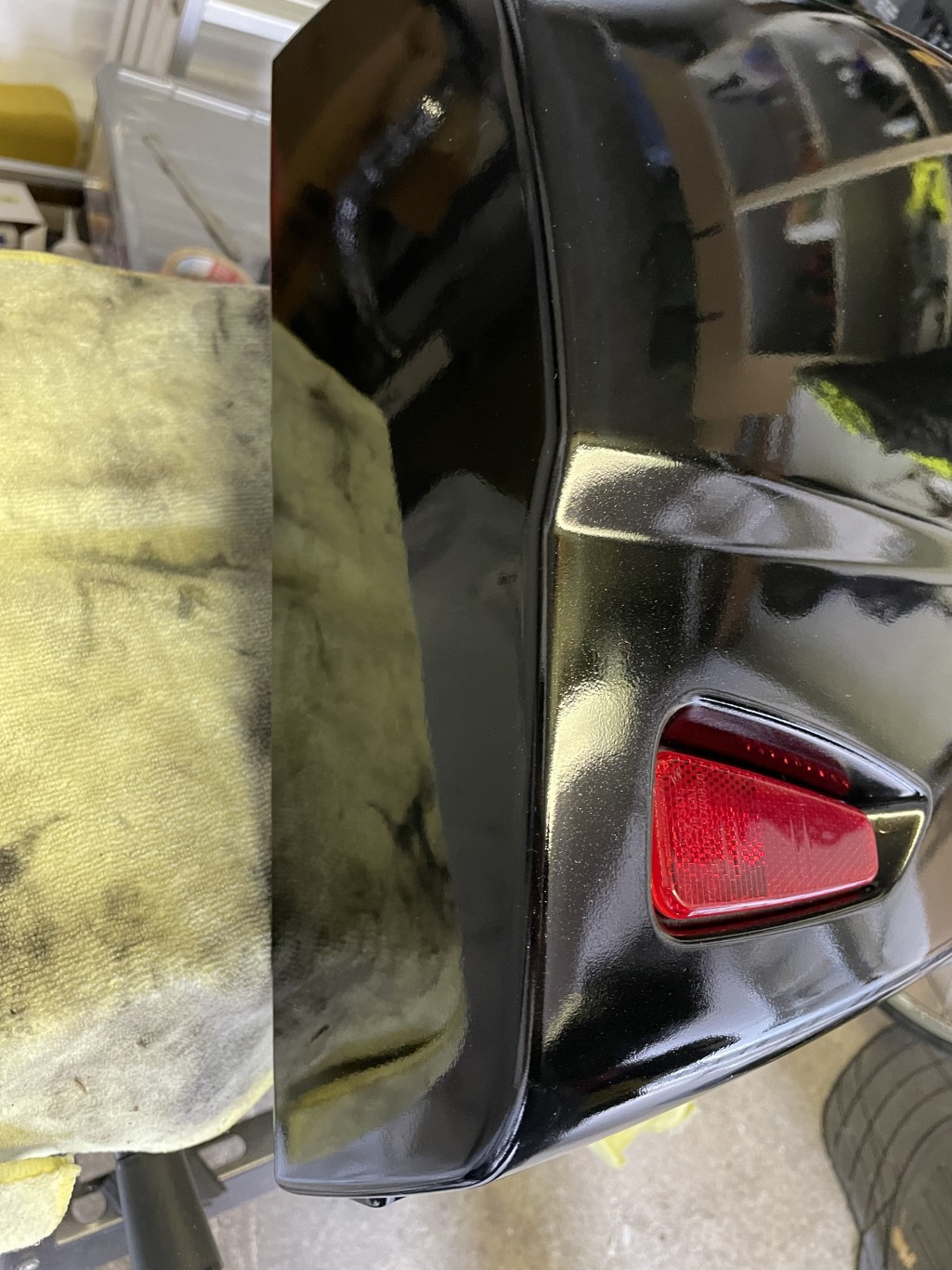

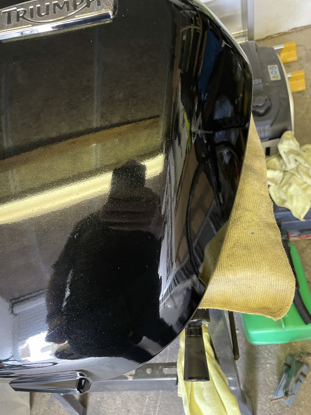

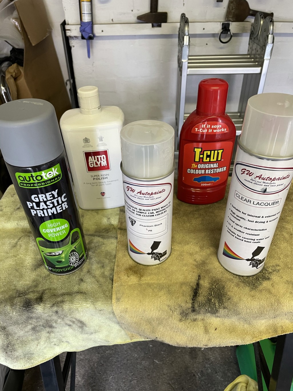

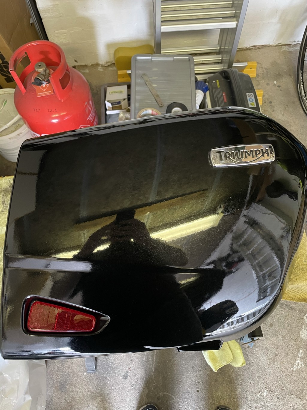

Here are some pictures of the end result. The shiny bits are the sparkly bits in the paint.
Overall finished cover
Area that was damaged
Rear of cover
Products used
