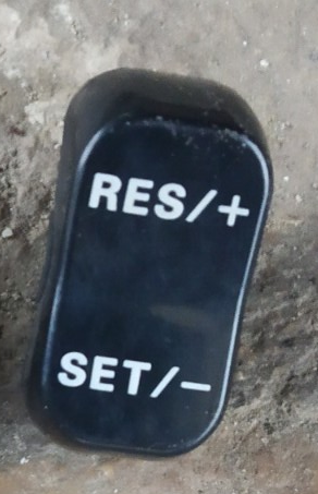

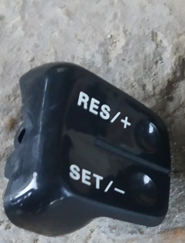

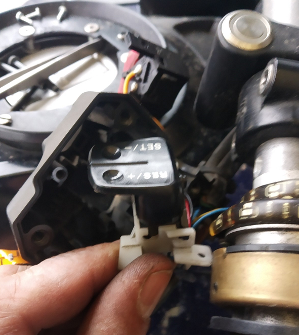

It is only about replacing this plastic of TTSE 2012-2015
for this other from TTSE 2015 onwards

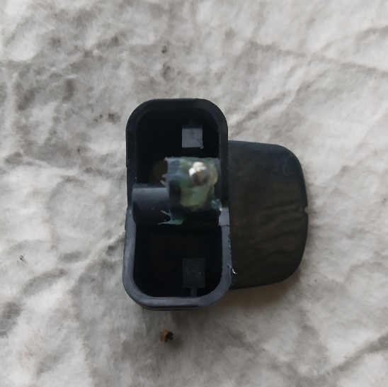

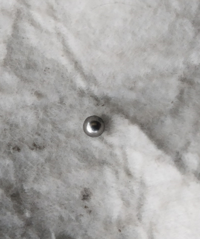

We see that inside they have a spring with a ball
Be very careful with that ball !!!
Before reinstalling it, grease the plate where the ball is located well with grease, so it will be hooked and it will be somewhat more difficult for you to lose it.

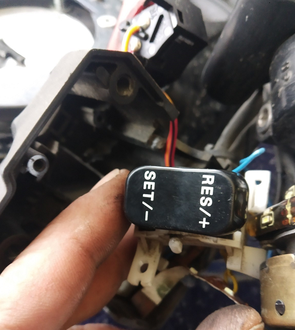

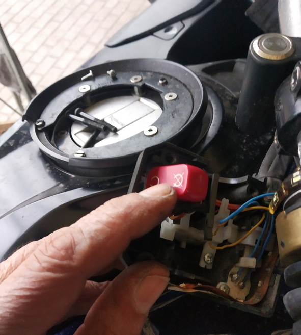

To facilitate the disassembly and assembly of the cruise control button, remove the screw that holds the engine stop safety switch and remove that red button as shown in the photo
Now we have removed the old pushbutton and we can now place the new pushbutton

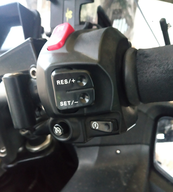

Now you can place the black plastic of the cruise control button on the two microswitches of - +
Finally, as we can see, we have the new result
