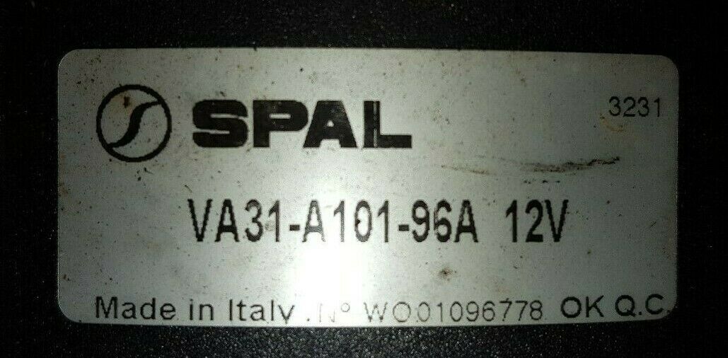

Hey,
Yeah sorry about that been really busy of late.

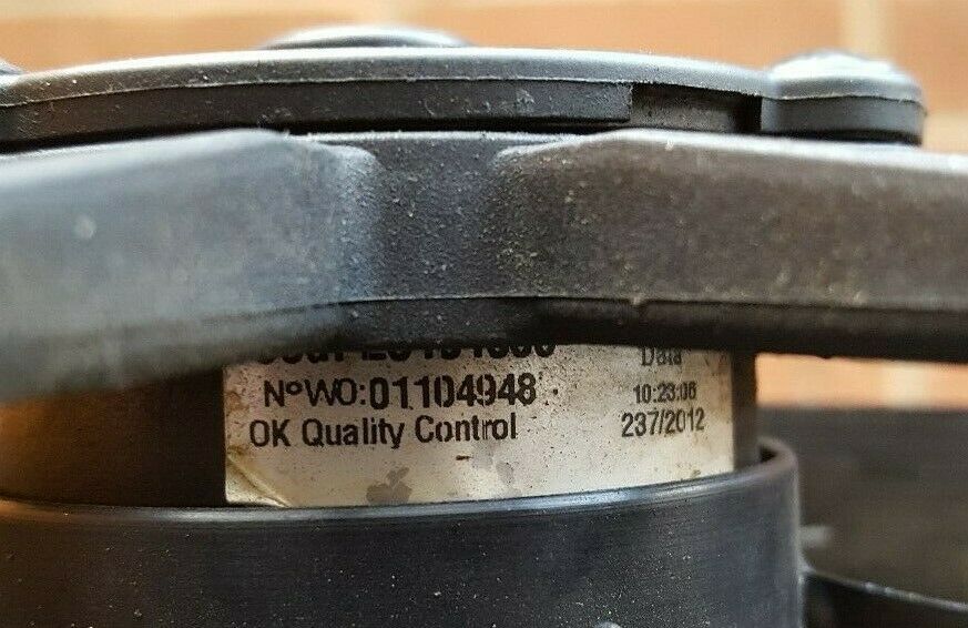

In the end i took the plunge and got the one in the pics of ebay.
The part code after searching was VA31-A101-96A.

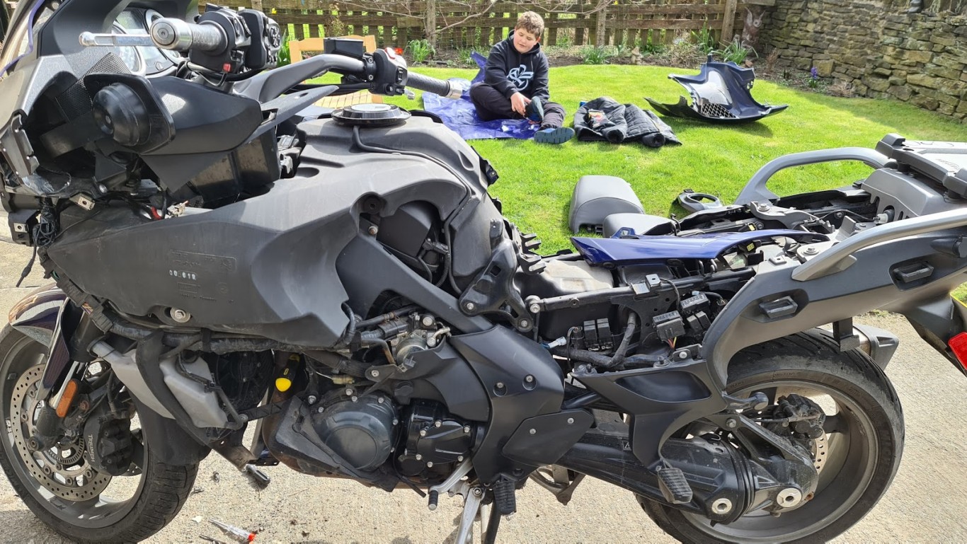

After spending a good couple of hours learning how to take the fairing apart, managed to get to the old fan, which had deffo died, to then find that one of the bolts had siezed, so with some persuation managed to get off and this one put back on.
It works a treat and no issues, spacing for the bolts and everything matched. The only diffrence i found was the wire was about 1/2cm longer than the broken one.
And so far has been spot on, i can hear both fans come on ok, and the newer fan spins freely
