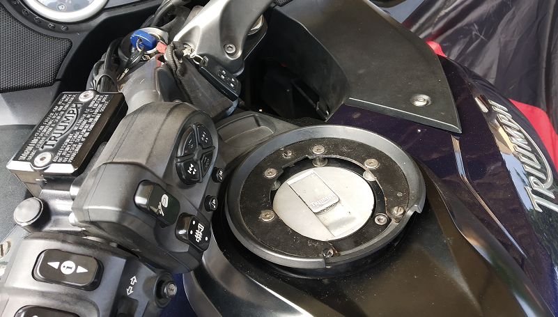

    Yes you can. I carry a small bag with a ring. I do not remember the reference of the ring, I only remember that it is from Givi for Tiger Explorer. I will look for the reference.
    • Trophy God  ‐    2956
    • Posts: 2956
    Re: Triumph tank bag lock ring
    Reply #4 on: Oct 16, 2021, 08.48 am
    The ring is this with the TANKLOCK BF02 system:
    Here a link:
    https://www.givi.es/para-tu-moto/product/triumph/tiger-explorer-1200-12--15/optionals/bf02
    To adapt the ring to the Trophy you must replace the 4 screws and put some longer than the OEM and stainless steel ones and place 4 stops so that the ring rises a little higher, otherwise you will not be able to put the bag. Once you have all 4 height stops, you will have no trouble removing and replacing the bag. I've been using it like this for years.

    Yes, with this bag since it touches the handlebar a little and when I stop as it is very big and when I stop the bike at a standstill, it touches the handlebar a little. So I stopped putting it on the handlebars and use it to carry work tools. But I keep in a saddlebag.
    The one that looks perfect is this other bag that I carry, I wear it when I go on a trip and I have more than enough space to carry a lot of things. Above all, the best thing is to pay the tolls of the highways, etc, etc.
    • Trophy God  ‐    2956
    • Posts: 2956
    Reply #7 on: Oct 16, 2021, 08.25 pm
    I have placed the bag so that you can see how it looks, it does not affect the driving at all.
