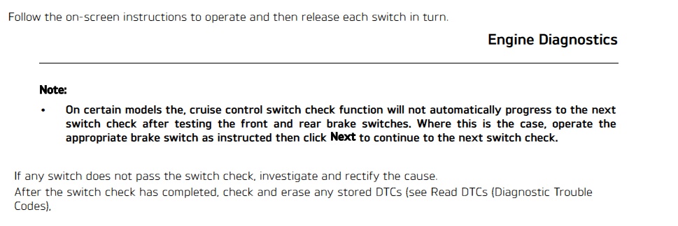

    Now I seek detailed information on this and provide it to you.
    • Trophy God  ‐    3048
    • Posts: 3048
    Re: Cruise control - is it broken or am I not doing it right?
    Reply #5 on: Aug 12, 2022, 10.29 pm
    Last Edit: Aug 12, 2022, 10.42 pm by digital
    • Trophy God  ‐    3048
    • Posts: 3048
    Reply #6 on: Aug 12, 2022, 10.45 pm
    I have dited the image several times and I see it small, if you also see it small, I suggest you download the image to your computer.
