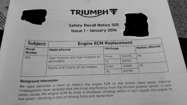

1. ECM recall                   (VINS 561284 to 637165)    Recall notice   505 (this can incorrectly appear as being a  TPS problem mentioned in many message threads here in this forum). Thanks to Troppo for the copy of the recall notice  below <others needed>): (handwritten vin number edited out):
Note:When going for the ECU recall, be sure to bring ALL your bike's keys to the dealer,  if you still want all your keys to work!  (thanks go to BloodBiker for this info). However, some dealers only seem to require one key, so ask your dealer or else bring both keys.
Also, after this recall is done, be sure to check that your cruise control still works (this info. comes from one of Coconut's messages). If it does not work, try a reset. See Coconut's "CRUISE CONTROL NOT FUNCTIONING" reset instructions here.

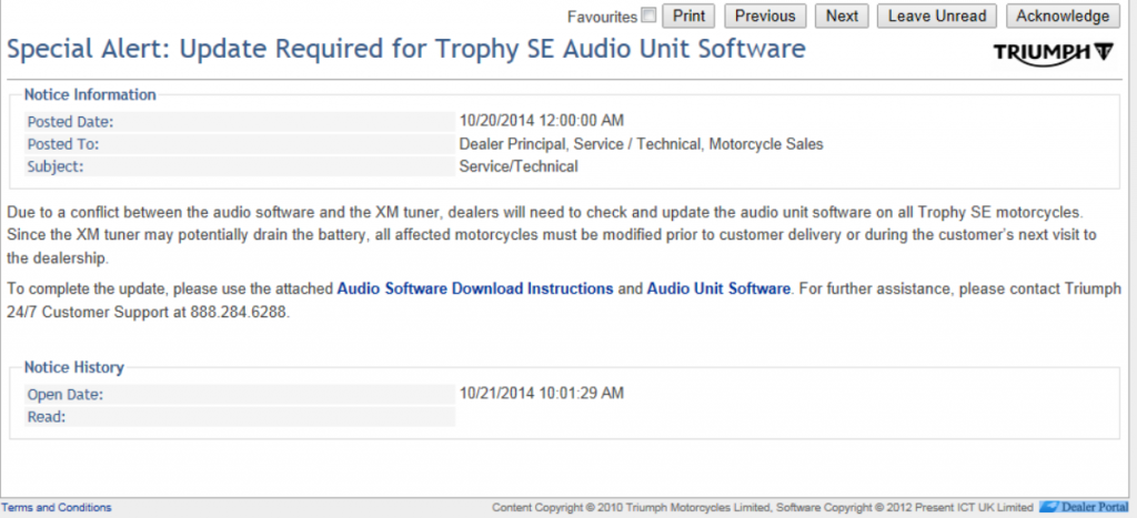

6. Battery drain problem (Thanks to Fastwheels for this one):
The symptoms of the above problem is a one amp battery drain when the ignition is off. If the stock GPS cable is used for GPS power, this condition is shown by the GPS not switching to battery mode when the ignition is off. A temporary  fix is to remove the audio fuse for a few seconds to reset the audio module.
