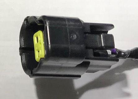

OK, I need some help.  What am I missing?  I have the GPS power connector, part number A9930122.  But the connector does not mate up to the one on the bike, like in the picture posted by Author.  Any ideas?   :157:

There's a Blanking Plug in the socket -
Depress the little catch on the side of the socket and pull it out,
then the new Plug will go in !  :028:
Here is a Photo of the Nav Power socket with the Blanking plug removed,
and you can see the release catch on the right hand side :

Thanks.  I figured out the dummy plug 10 minutes after I posted this.
