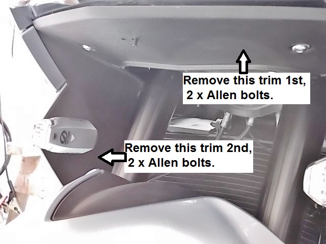

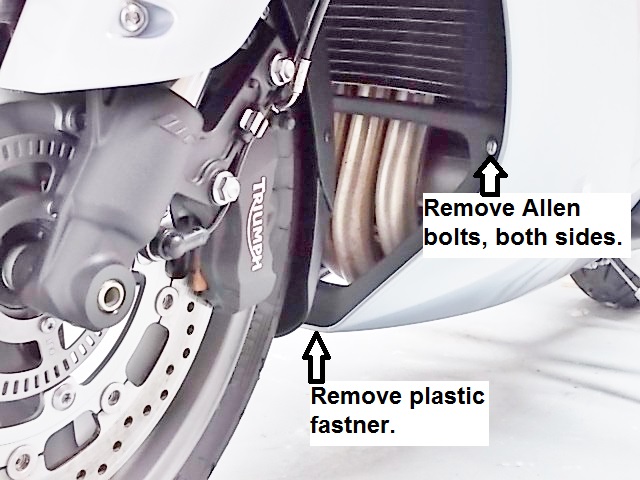

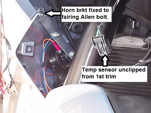

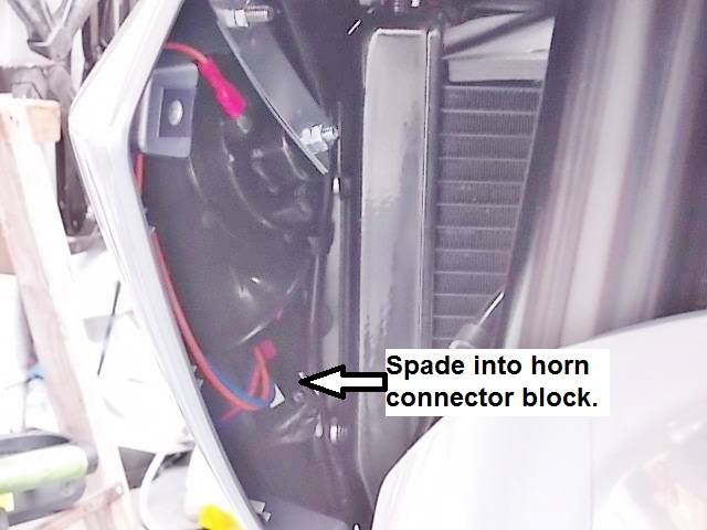

Hope this appears as a logical process -
1st step, remove black belly pan rib. [2 x 5mm Allen bolts] I had to knife the posi-drive plastic fastner under the pan and replace with similar when finished.
2nd step, remove horn [single 12mm bolt] and wire connections.
3rd step, remove trim.
4th step, fix bracket as photo, connect both wires to horn with 2 spades on other end of wires & bolt horn in position.
5th step, connect spades to wire block and tidy wires.
6th step, test horn, re-tune if needed & replace trims etc.
