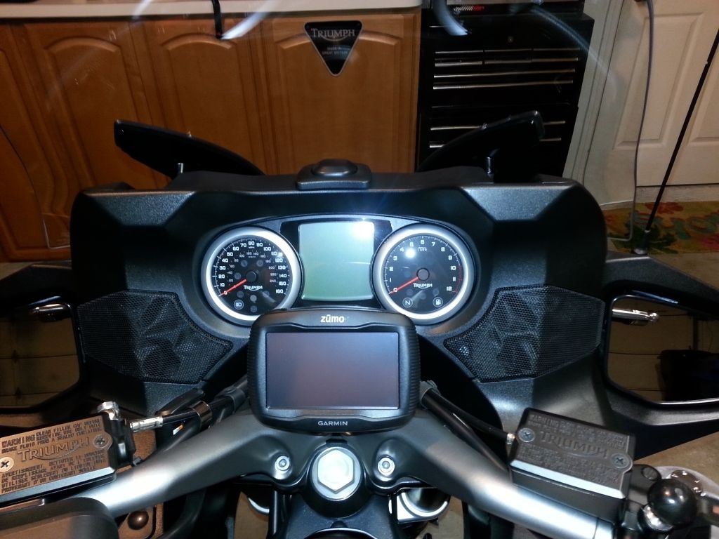

    Does anyone have the dimension between the closest 2 handlebar bolts so I can make a mount for my GPS?   I'm eyeballing a distance of around 27.5mm.  I've seen a few photos of a mount with 2 spacers and a cross plate with a 1" RAM ball attached.
    I've also seen a setup using the lower 2 handlebar bolts for the mounting location.  Any advantage to using the upper or lower bolts to mount the GPS?

    I don't have the distance between the two bolts, but I can measure for you when I get home from work. I recently went with the front two bolts to mount my Zumo GPS using the ram mount, the ram mount allows good adjustability. I chose the upper bolts because it put the GPS a little closer to the dash, and if you use a Tank bag (I don't), more clearance for the bag without blocking the view of the GPS. The one down side is that placing or removing the ignition key requires reaching over or around the GPS.

    Thanks for the info and picture.  No need to disassemble to get the dimension.  I can get an accurate measurement when I make the parts.  Just thought someone may have built their own and had a dimension handy.
