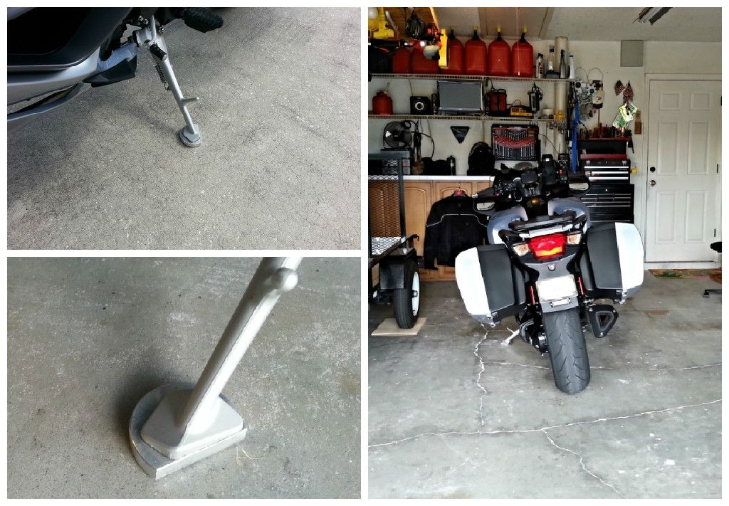

    A couple of months ago I mentioned that I thought the side stand on the trophy was a little short, and the lean angle while on the stand a little excessive. The angle was so much that I couldn't sit my helmet on the bike without it rolling off. I started looking for a stand extension for the Trophy that would also give it a little larger footprint, but was not able to find one that did both. So, about a month ago I made one that I cut from an aluminum block. I cut it 3" round and 1/2" thick. I had to cut the left side of the puck to fit flush on the left side of the side stand to prevent it from hitting the shaft housing when the stand was in the up position. I was able to reduce the lean angle and now have the angle where I feel it should be. Also, a little larger footprint to help prevent it from sinking in soft surfaces. This is what it looks like and the new lean angle.

    Great!  How did you attach it to the sidestand???

    I used a 6000 psi two part epoxy.
