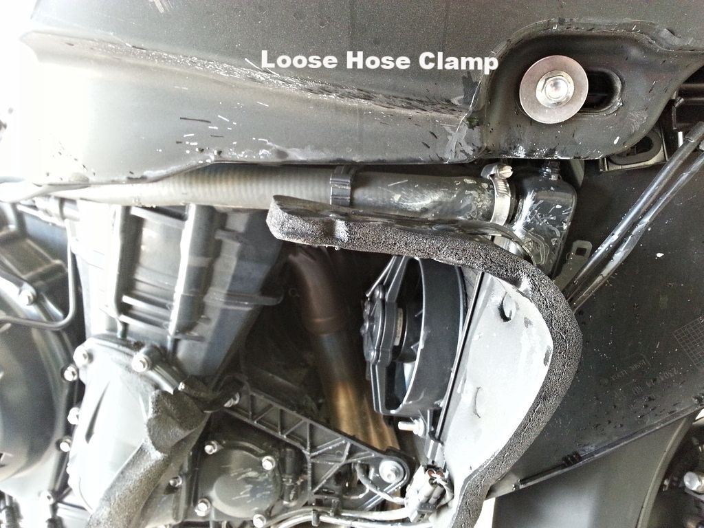

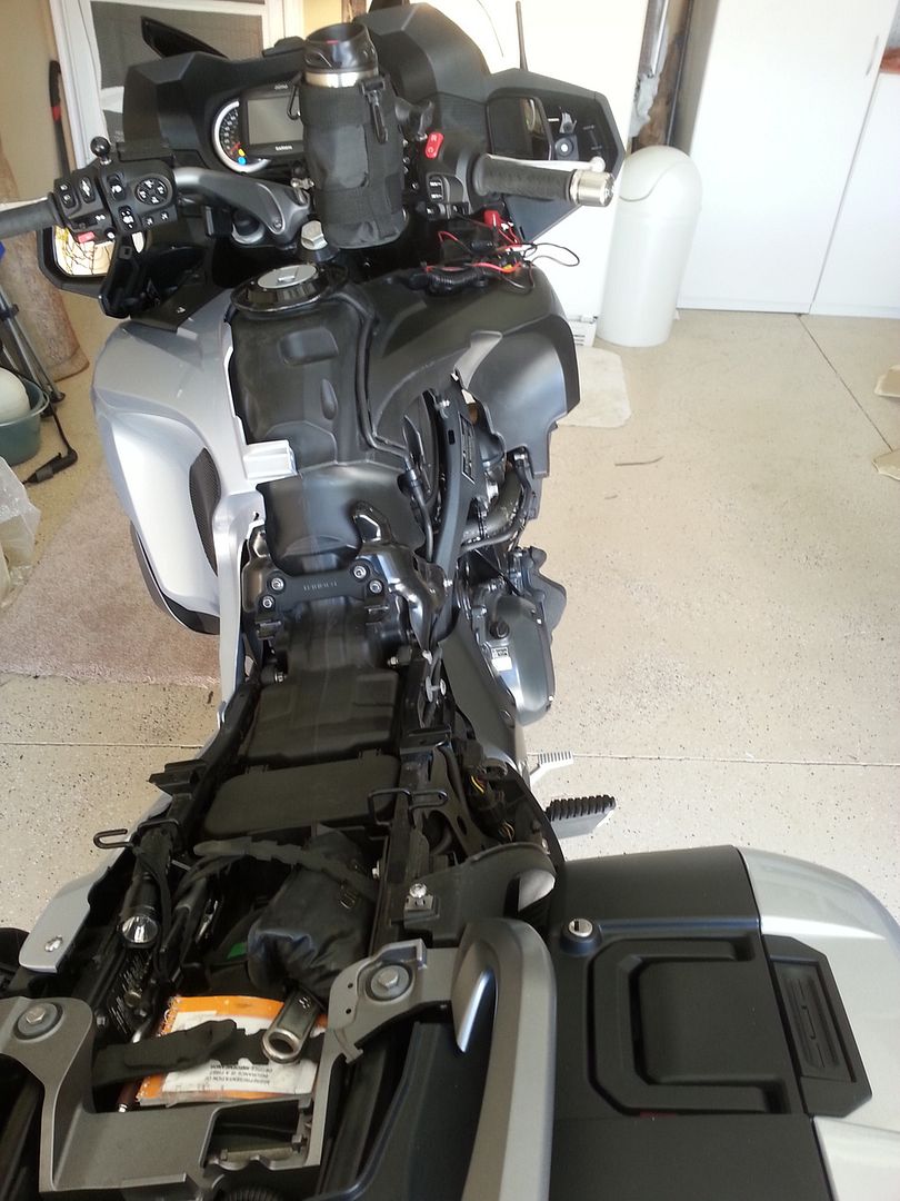

    I was heading back home today from a weekend trip. Traveling on the interstate at about 80 to 85 MPH, I was a couple hours from home when I felt my right lower leg getting wet. I looked down and saw fluid spraying from the right side lower vent. I immediately took the exit and shut the bike down. After inspecting the bike, it was engine coolant, Just wonderful. Fortunately while I was standing there thinking about pulling the body panels off the right side, a nice guy stopped and offered me the use of his two car garage about a block away. I took him up on the offer. After pulling off the right side panels, I saw the radiator hose had just about backed off the radiator nipple all the way, maybe still on there by an 1/8 inch.
    The hose clamp was so loose that I was able to slide the hose back on and move the hose clamp around by hand. In the last photo, you can see that I had pushed it back on and clamp still loose. All the messy stuff in photo was dried coolant, it wiped right off with a damp cloth. I was experiencing the infamous loose hose clamp issue that so many others have reported on. Anyway, a couple of hours later I was back on the road and made it home without further issue. If you're ever planning on a long trip, you might want to check on this clamp as many others have experienced this exact same loose hose clamp issue. I've been meaning to, but never did. Definitely not much fun to have to pull all the plastics off one side when your not at home in your own garage with your own tools. Just wanted to share my experience today. Safe riding everyone.

    Both of my upper rad hose clamps have needed to be tightened since I got my Trophy. I was able to access them from the front without removing any fairings. Used a short combination wrench.
    That was my first attempt, all I had was my bikes tool kit, a large adjustable wrench and a pair of pliers. The way it was spraying out of the side vent, I thought I had a busted hose or worse.
