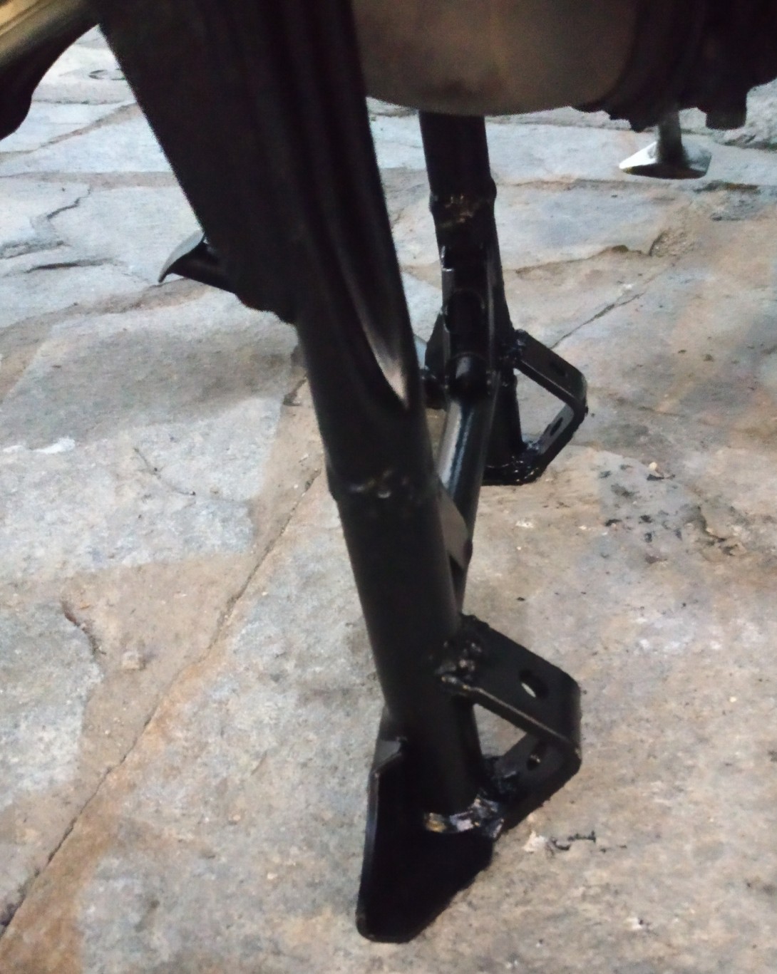

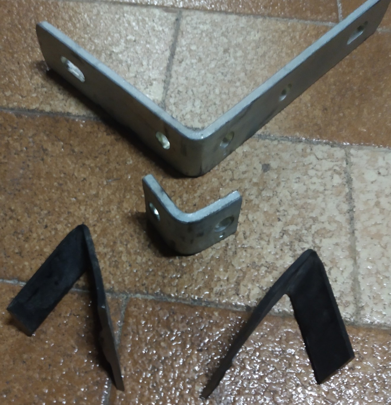

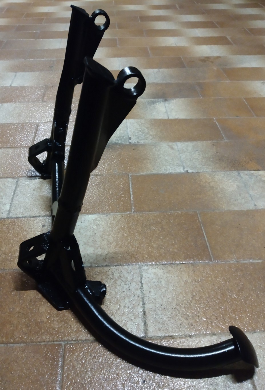

I cut the centimeter to the easel and put two pieces of solid sag at each end of the tubes and both soldiers.
Then, I cut off the fins that are strong when supporting the ground, and I made the ones shown in the photo. Now with less force and loaded suitcases, it climbs very easily.
