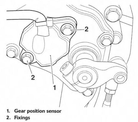

    you probably have a faulty Gear Position Sensor,
    which is located at the left side of the Trophy immediately in front of the Gearbox input shaft,
    ( obscured from view by the plastic panel carrying the Power socket next to the Riders knee ).

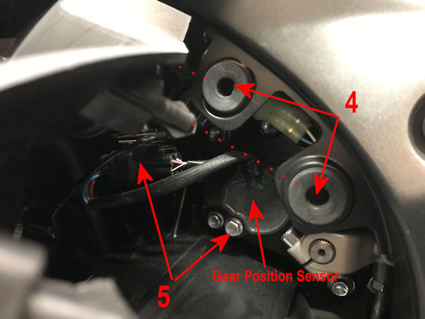

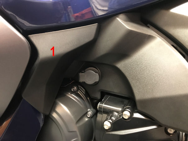

    1.  Remove small trim piece held in place by 2 pegs into rubber grommets - it just pulls out.
    2.  Remove the exposed Screw ( 5mm hex )
    3.  Remove the other smaller retaining screw ( Easy if Fairing is removed, fiddly if it's not ! )
    4.  Pull the rear edge of the panel carrying the Power socket outwards -
         again there are two pegs located into rubber grommets.
    5.  The Gear Position can now be seen - separate the wiring connector, remove two bolts
         and withdraw the sensor.
