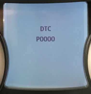

To access any FAULT CODES ( Triumph calls them "Diagnostic Trouble Codes" or "DTC's"),
there is a different process.
From Ignition OFF, Press and Hold in the "SCROLL UP" and "i" buttons together,
and keep them pressed in while turning on the Ignition - Don't start the engine,
but continue to hold those buttons in until the Speedo & Tacho needles
have completed their sweep, and this Screen will then be displayed :
"P0000" means there are NO Fault Codes ( DTC's ) Stored  :028:
If a Code ( or Codes - there will be an Option to Scroll if there are more than one ) appear,
refer to this Topic :
Servicing Data, Reference Info. & DTC ( Fault ) Codes - Scroll to Reply #8 ( "Diagnostic Trouble Codes ( DTC's ) / Fault Codes" ),
and at the end of that Post you will find a Downloadable Document that lists all of the DTC's.
together with a brief explanation of their meanings, and other information.
No external equipment is needed to read these codes, or to reset most of them, which will reset
and / or be deleted after a specified number of "No Fault" starts, as explained in the above document.
If you have the "DealerTool" device, this can assist with troubleshooting some problems,
and can also be used to erase DTC's ( once the fault has been rectified ) earlier than waiting for
those specified number of "No Fault" starts.
If you need help with any Codes that you have, Search the Forum for that Code to see if a solution
already exists, or create a New Topic quoting the Code and the symptoms, if any, that occur.
