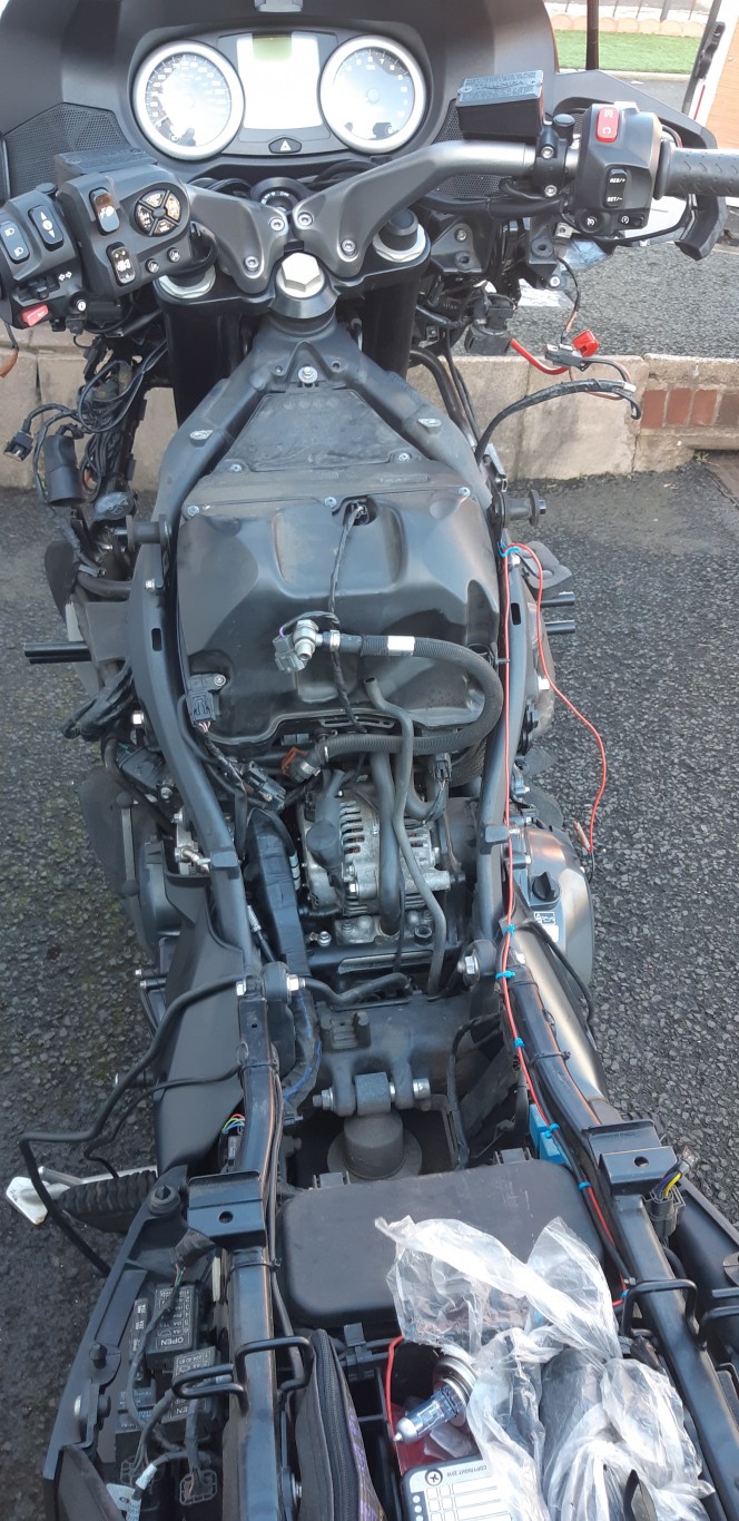

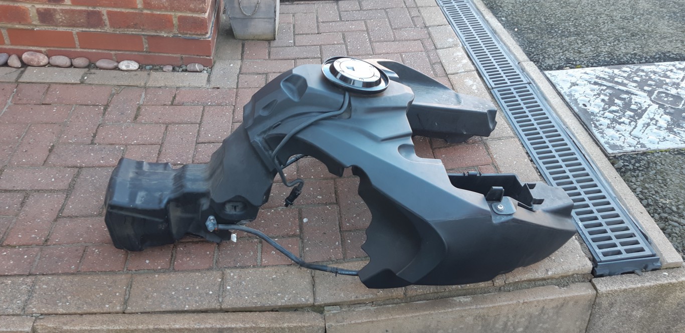

    Having removed the crash bars and all body parts, my back yard is looking like a Triumph body supplier  :008:..I drained the tank, note to one's self, do not fill it next time before starting the work  :164:, fortunately I found a clean container to drain the fuel into at one of my clients.

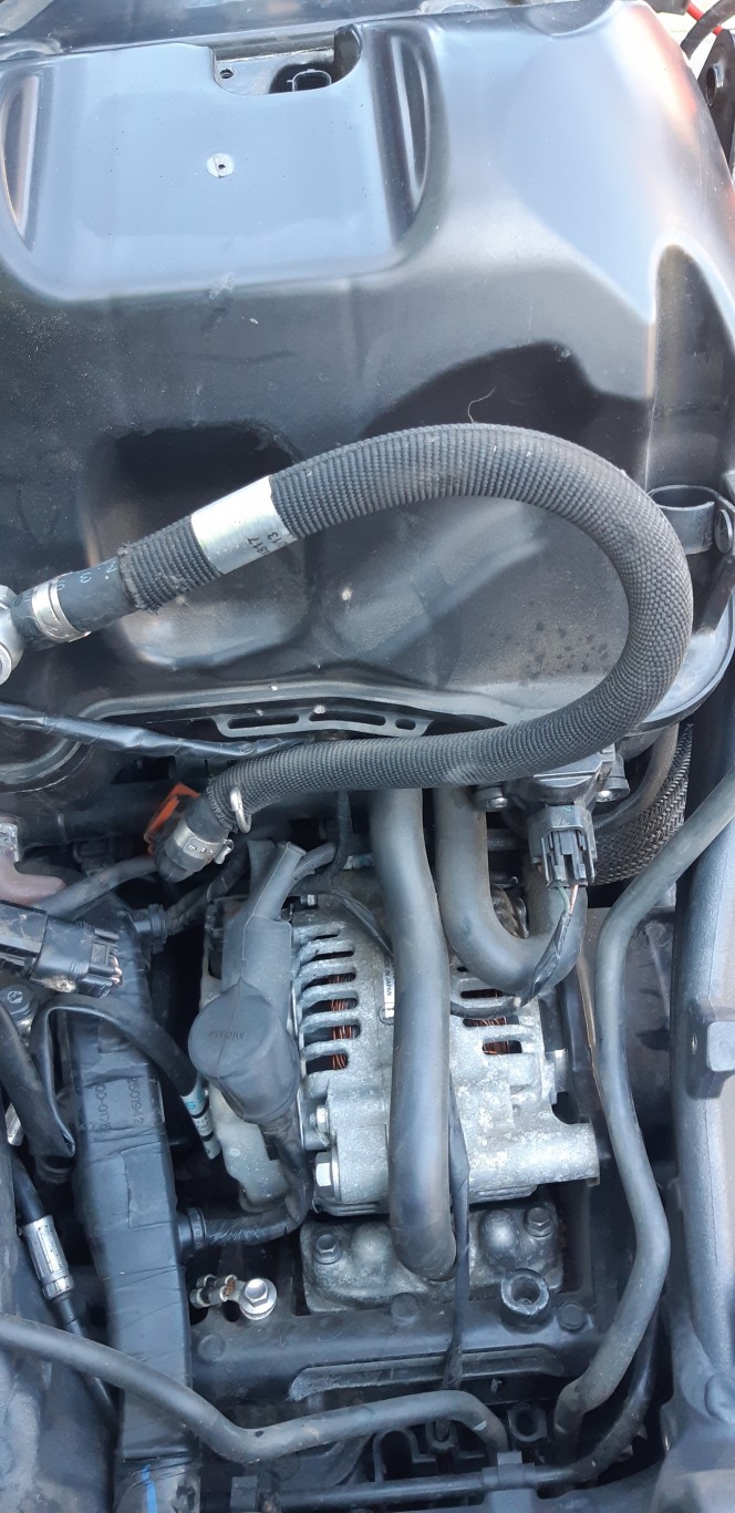

    Tank drained, all connections disconnected, following other members posts on here for instruction / hints etc and said tank removed, I have to admit, I was a little surprised by the size of it, don't know why though.
    Airbox removed, filter replaced, and laid to one side, again, surprised by how clean it was for the mileage.

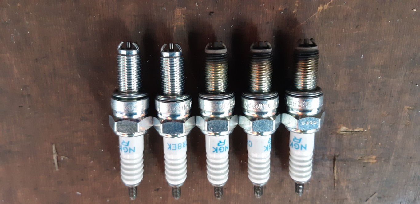

    All parts I have used are Genuine Triumph, I fitted 1 spark plug then decided to photo them  :138:
