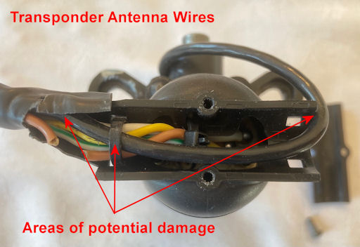

    Members may already know about the problem of Ignition Switch Wiring failures,
    discussed extensively in these Topics :
    Ignition Switch Wiring Failures,
    Complete electrical shutdown,
    No Horn, Front & Rear Position Lights or Brake Light,
    Ignition switch diy repair,
    .... and probably several others.
    I have noted that Members increasingly reporting such Faults are receiving a response from Triumph
    that it is NOT a "known issue" and are not receiving any help with rectifying the fault.
    ( Most Owners are now out of their initial 2 year Warranty period ).
    More importantly than the financial cost and inconvenience of repairs, it is my personal opinion
    that this is a SERIOUS Safety issue where a rider could experience a total loss of power while riding,
    with no warning, that could easily have disastrous / fatal consequences.
    It is for that reason that I have published the below list for reference,
    collated from many of the Posts within this Forum, clearly demonstrating
    that this is NOT an isolated problem.
    I am not normally the rebellious type, but as can be seen from the List,
    this problem can affect ANY Trophy from 2012 onwards, and I intend to write
    to both Triumph and the UK Driver and Vehicle Standards Agency ( DVSA )
    urging Triumph to reconsider this matter, and devise a solution that can be applied
    as a Safety Recall, BEFORE the above potential consequences are realised.

    Update 22/09/19 :
    Triumph received my report on 17/09/19.

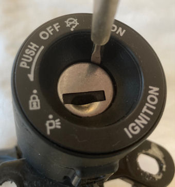

    DVSA have also received my report, and after asking for a little more information have
    completed their Review stage and have contacted Triumph requiring a response from them.
    Some Good News is that Triumph do now seem to have acknowledged this as an issue,
    even before receiving the report etc, as a modification has been made to the Wiring
    where it exits the Ignition Switch, by enclosing it in a tougher plastic "shroud".
    Unfortunately this doesn't seem to have cured the problem as a Trophy I looked at today,
    which had the Modified switch fitted at a Triumph Dealership just 5 days ago,
    already shows signs of the new shroud being pulled out of the base of the Ignition switch,
    with the individual wires visible, and I fear it will only get worse the more the bike is used,
    until the wires get sliced apart again due to their close proximity to the Brake hose !
    But it's a start, and until Triumph respond it would not be fair to comment further.

    UPDATE 25/10/19.
    Triumph have responded to DVSA with their initial findings.
    Triumph have already implemented a modified Ignition Switch
    with a tougher protective shroud around the wires.
    Unfortunately this does not seem to have resolved the problem
    as one such modification is already showing signs of failure after just 3 weeks of use
    where the shroud is being pulled out of the housing exposing the wires inside,
    that will then be vulnerable to the same shearing / scissoring action.
    Triumph and DVSA are now aware of this latest development / failure.
    Triumph have stated,
    "Triumph's intention is to investigate this issue fully.
    We will then implement any actions as required." -  which is excellent news !

    The modified wiring that they had fitted to one Trophy, which subsequently began to fail again,
    has since been replaced and the modified part should by now have been examined
    by Triumph, and hopefully another solution will be forthcoming.
