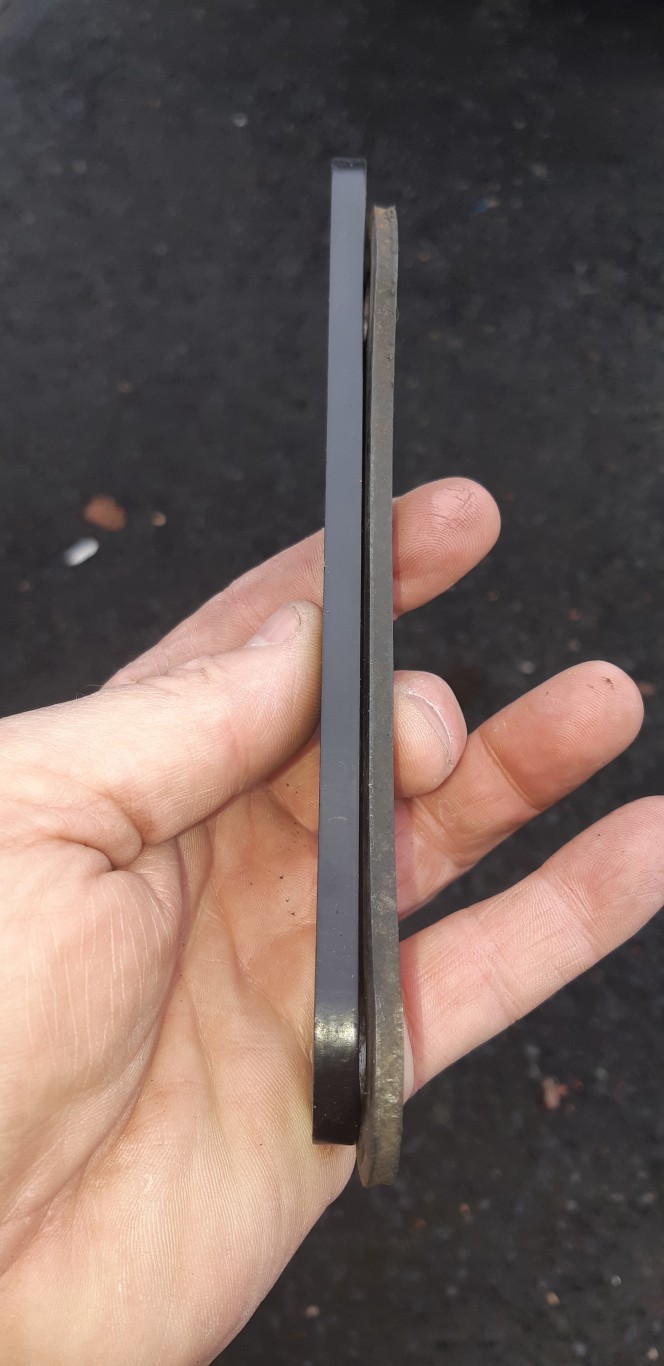

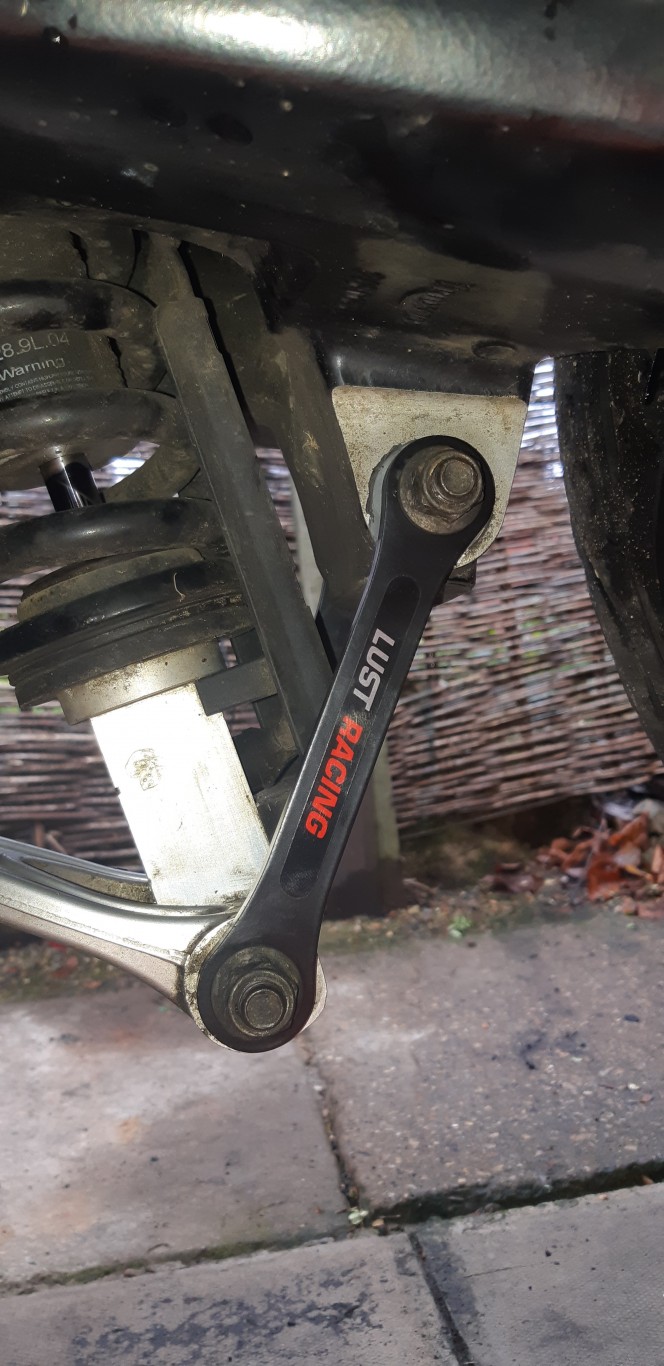

I looked on the World Of Triumph web site for a price,  :164:...after I finished laughing I phoned my local Dealer, the "part" from them is £686, WOT wanted almost £800...the guy on the parts counter gave me a web address for a company that do a 3 into 1 set up, aftermarket part for around the £270 mark...I have yet to look at the site, but my dealer have had parts sent there from other Triumph owners, they do all sorts of stuff apparently, Lextek Motorcycle Products...anyway, it will have to stay like it until the new year now, I replaced the rear Links, refitted the silencer, I'm kind of surprised it's not really blowing, only ever so slightly, and it,s no noisier then before. What did surprise me was the difference in the thickness from the OEM link to the new one, Triumph link 4mm...Lust Link 6mm..the other thing that messed with my head, you have to have a longer link, to lower the suspension  :187: :027: :087:

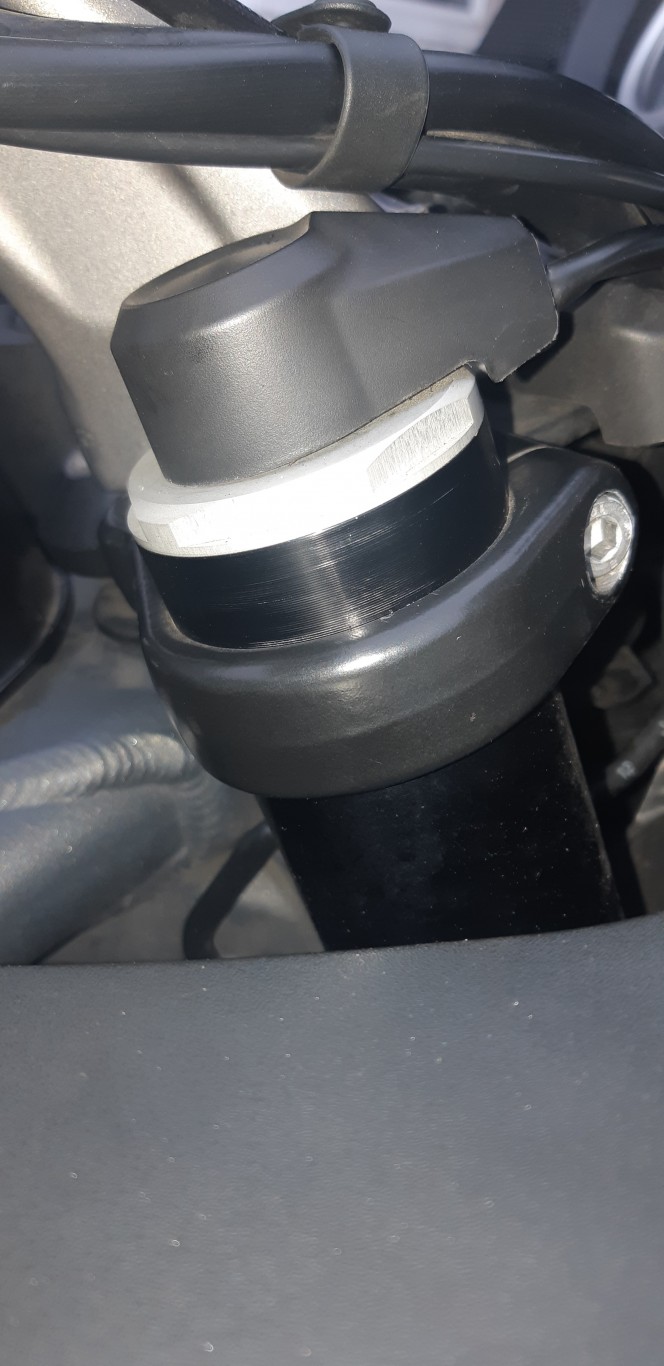

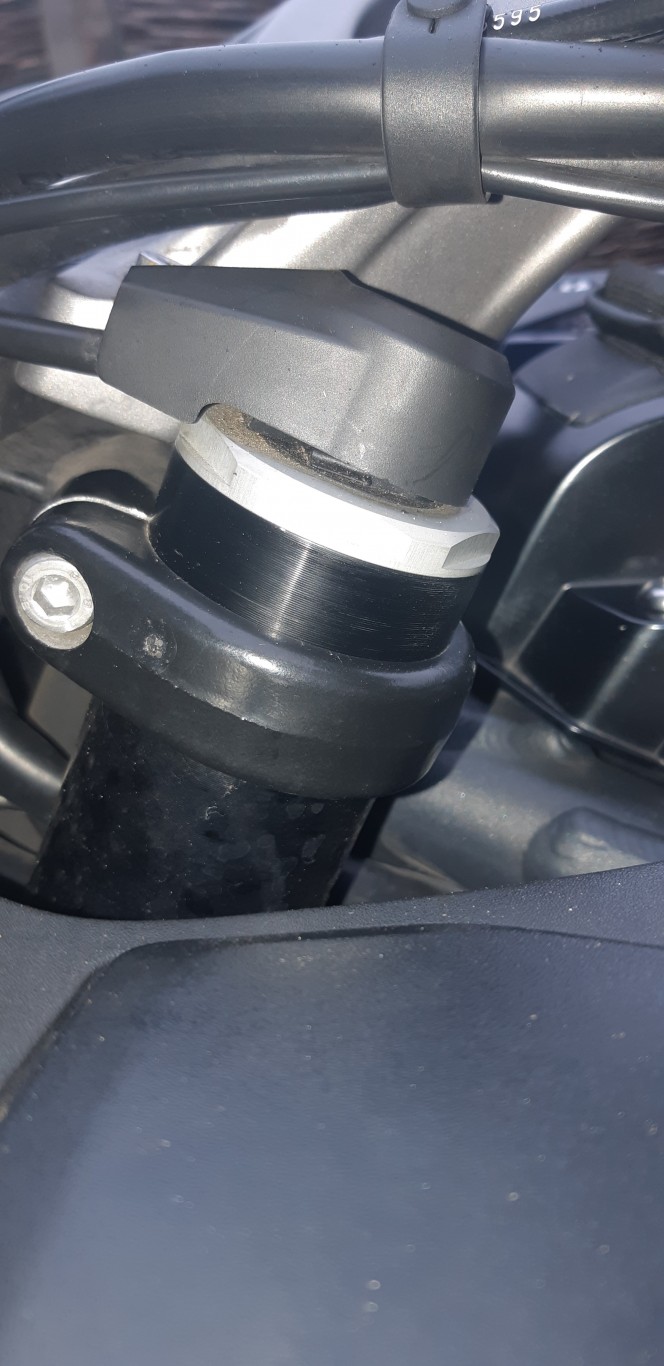

Anyway, I progressed to the front forks, this was just as easy to do, reading the fitting instructions  :169: that came with the drop links..Lust Links...they say to lower the forks 14mm, this I did, fastening everything back up to manufactures spec, I let the engine management do it's calibrating thing, and for the first time I can get my feet flat on the floor, I have not done a road test yet, I will do that tomorrow....A big thank you to Guitarman for sending me the Droplinks, top man.
