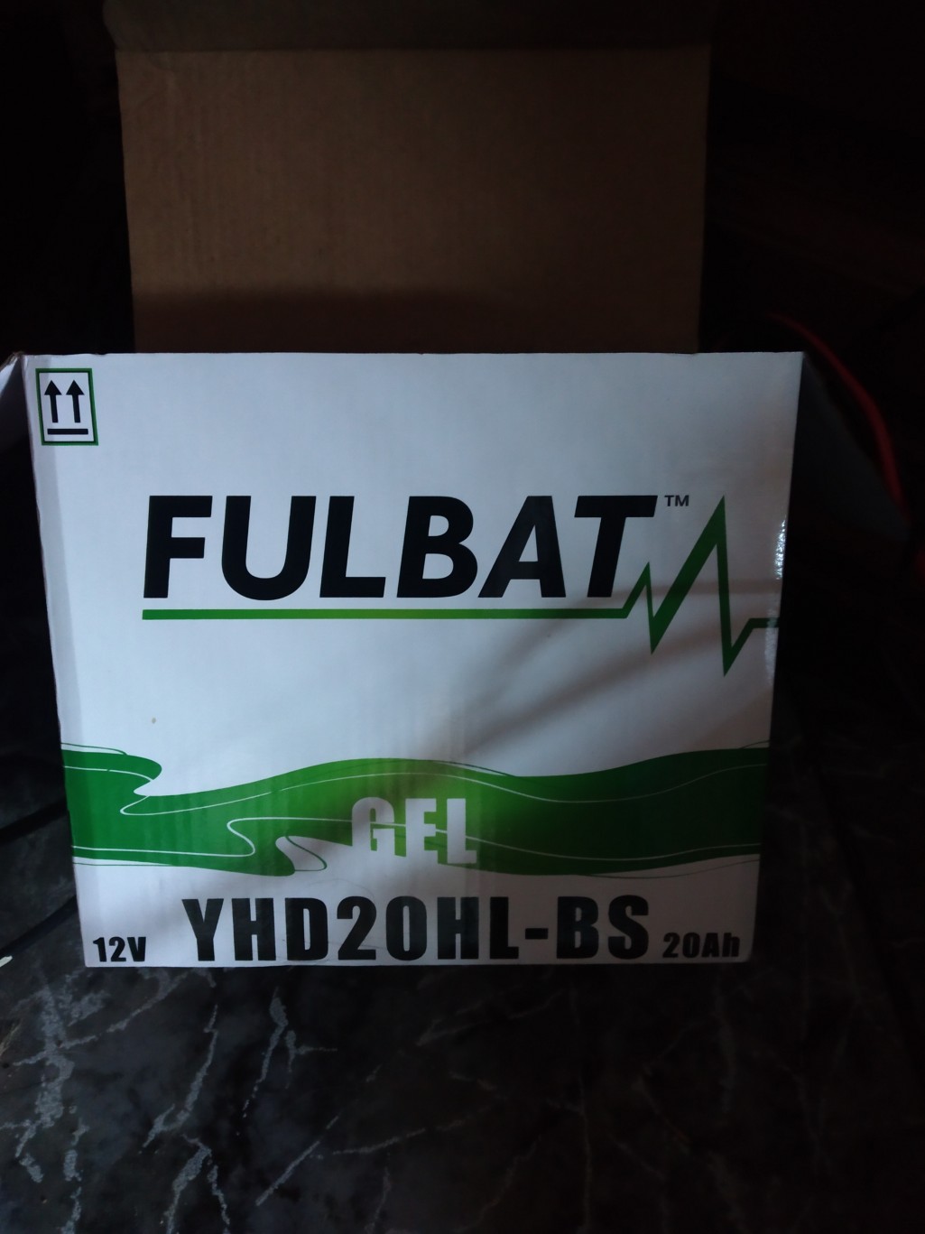

    In case someone may be interested in replacing the battery, this Gel, for our motorcycles, is phenomenal.
